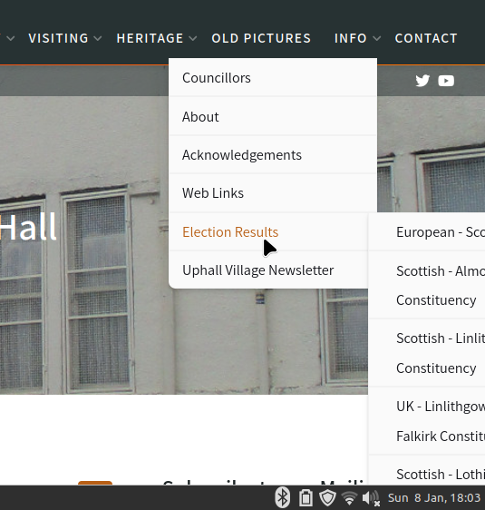

To make the site perfect, I am looking to set the width of the sub-menus. Each sub-menu is either 2 or 3 columns wide. I saw code such as the code below, but this hasn't had the desired impact
.hornav .item-511 ul {
min-width: 270px;
A screenshot of the issue is attached:

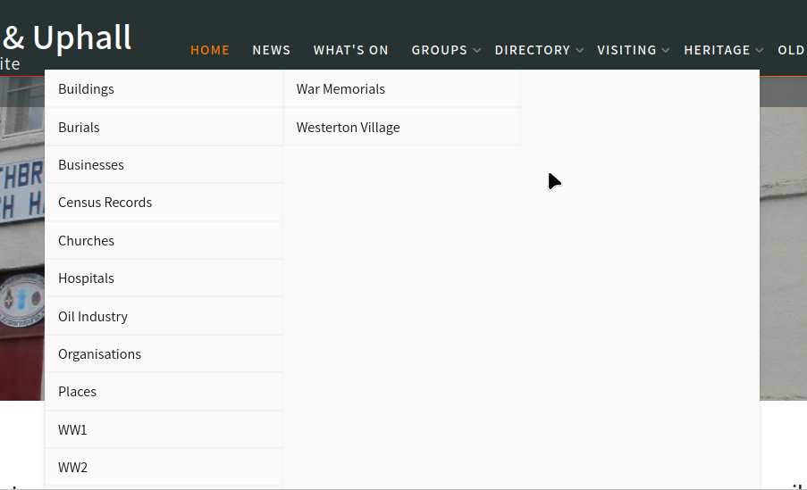

However:
1) is it possible to set a minimum sub-menu width at parent item level?
2) is it possible to (as per image showing Election Results sub-menu) to have its sub-menu on the left?
3) the 'heritage' menu, despite being set-up as columns-2 or columns-3 is not displaying correctly. Can you look into it?

2. / 3. On these items, get back to us once your site is available online and we will look into a possible solution.

I notice requested details have already been sent.
1. To amend try adding the following to the Custom CSS field of your templates parameters (Extensions -> Templates -> [YourTemplateStyle] -> Custom CSS)....
2. To amend try also adding the following (edit to taste)...
.hornav .item-590:hover ul, .hornav .item-590 ul {
left: -230px !important;
width: 230px;
}2. To amend try also adding the following (edit to taste)...
.hornav .columns-3 + ul {
max-height: 440px;
}Ciaran
