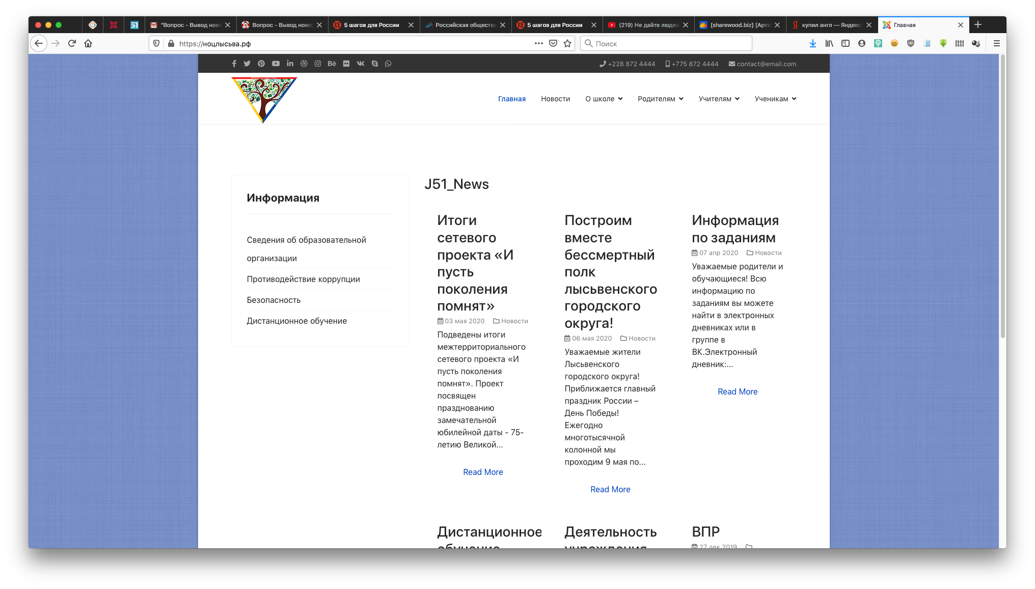

Hello! I bought News module yesterday and I have a problem. I using Helix3 template and when I installed this module, it displaying with default visual settings Helix 3 template? Why?
What should I do to fixing this? How to connect CSS of News module in joomla?

The module CSS appears to be loading without issue however some of your template CSS is overriding it. The news module is best used by adding an image to the Image and Links tab of your articles (Intro Image).

Hello! Thanks! But how to change displaying this module with your settings? What CSS overriding news module? Thanks for answer!

Could you detail for me in what way your styling is incorrect? The module is using your default styling for a button (no border, no background). Is it the button that is the issue? In all other aspests your news module is styled correct however I notice you have not added any image to your article.

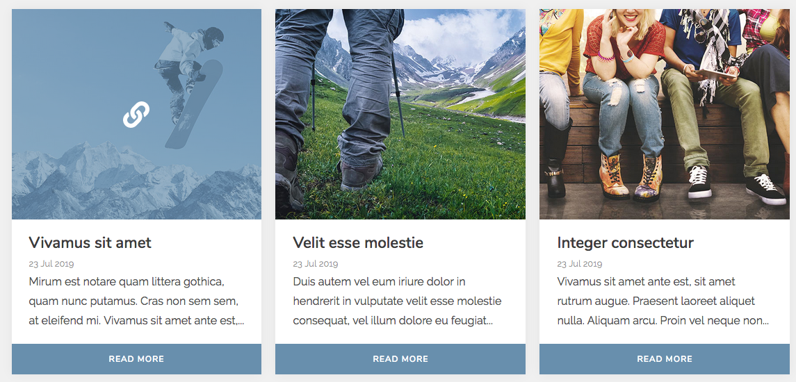

What do I need to do to get the same design of the news module as in the demo? Do I need to download your template? Or would it be easier for me to make it myself?
  3. # 6
Thank you for detailing.

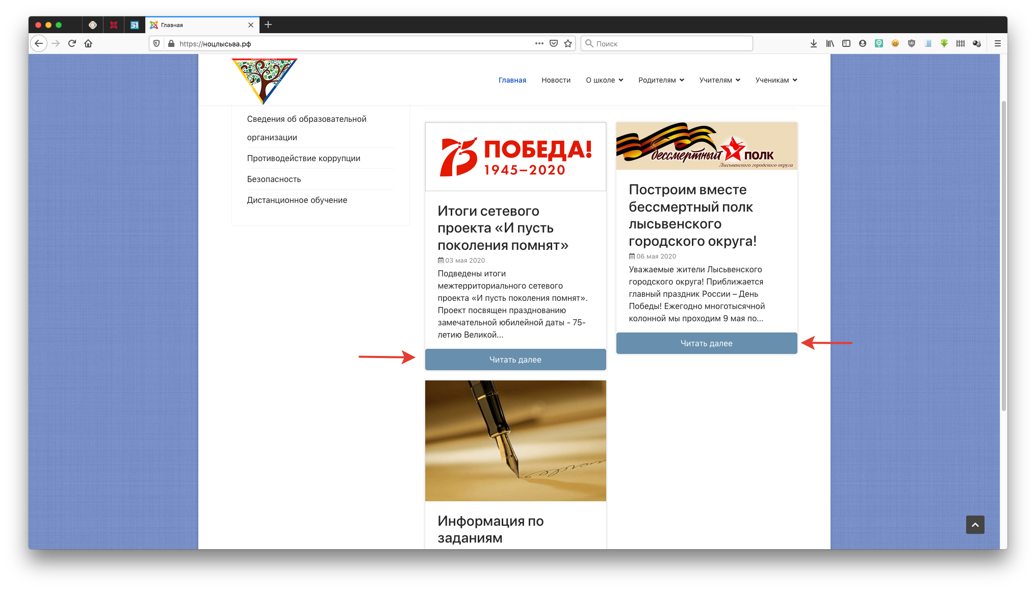

To replicate this styling, firstly ensure each of your articles has an intro image added in the Image and Links tab. To add the template styling as displayed in your screenshot, add the following to the Custom CSS of your template...
.btn.j51news-btn {
background: #688FAD;
color: white;
padding: 8px;
.j51news figure {
box-shadow: 0 0 4px rgba(0,0,0,.2);

It's works! Thanks a lot! And the last question: Is it possible to make all news items the same height so that the buttons are on the same level?
  3. # 8
One option is to add a minimum height to your module items with the following custom CSS (edit to taste)...
.j51news figure {
min-height: 480px;
